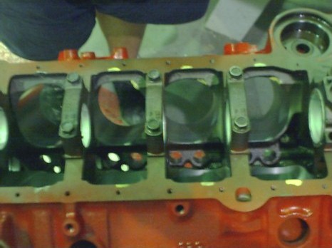

im surprised noone has mentiond that the 400 block has no cooling passages between the 2 center cylinders on both sides.....yea on a daily driver this probly wouldnt matter, but ona race motor where heat and wear & tear will basically melt the center pistons....my vote goes goes for a 400 on a daily driver...but for a race motor id be looking for the cooling aspect

Originally posted by ede
it's funny how many of you guys talk about the 302 and 327 being such great engines, better preformance, higher spinning, better milage and you aren't old enough to remember them, drove them, or worked on them. at best you've saw a few and have hands on knowledge of less than that.
all you have to do is ride in a stroked rustang...
331 ford isn't no more than a .030 302 with a 3.25 stroke, same bore stroke as a .030 chevy 327
302 ford, chevy made em too..........
dude you just don't know what your getting into when stroking a motor....... theres so much grinding and clearence checking it isn't funny........... below i have included a pic of the places that has to be grinded for a 383......
also i wanted to tell everyone somthing that i found interesting..... when fooling around with dd2000 the 383 i'm putting together put out the same hp and tq as the 355 did.........
now i don't know how accurate dd2000 is, but it must be close for everyone to use it.......
