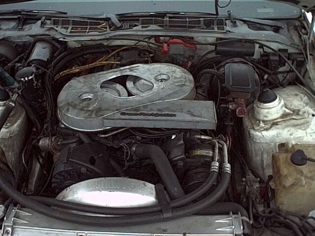

5.0 V8 with Cross Fire Injection. How do you call this engine? I read alot about LT1 engines and stuff like that, can you tell me the name of that engine?
See pic also!

That is an LU5 Crossfire Injection (CFI) 305 from either an 82 or 83 Z-28. The crossfire injection system consisted of two throttle bodies or (TBI), not unlike the Corvette setup of the same era. I hope this answers your question.

The cars 83 t/a, it's his second engine thou. How much hp, does it have?! Where can I get some info on it?

Check the Tech Data section of this site. You'll find that it was rated at:
LU5 V8: 9.5:1 CR, 5.0L (305 CID), 175 HP @ 4,200 RPM, 250 ft/lb @ 2,800 RPM, CFI fuel system.
You'll also find a lot of other useful information there and in teh Tech Articles section.
