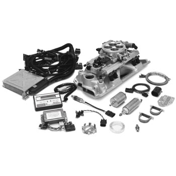

Has anyone heard of a nitrous kit made for this EFI setup or one that could be used? My main goal is to get fuel injection with nitrous. I know I could use a TPI setup, but I have heard that they are hard to tune. I like carburators but I want about 17-20+ mpg. I would appreciate any input, thanks.

You could make your own fogger system for it.

A plate-type kit for a 4-barrel carb would go right on.

Those NOS-zles, or whatever they're called (where the fuel injectors can inject nitrous as well as fuel), would probably work. I'll post a link if I can find one...

Found one...
http://www.holley.com/HiOctn/ProdLin...NS/NOSzle.html

I would love t have that NOSzle system, but with my budget I would have to settle for a dry fogger system. I found a bigger picture of the unit, and from what it looks like, maybe I can put a 4-barrel plate on it. Although I'm just guessing because it looks like it mounts just like an Edelbrock/AFB carb. I'm planning on running a 150 shot of nitrous.

Here it is:
