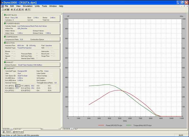

*** DAMN Dyno2000 is pissing me off!!!! No matter what, the LT1 cam give me less HP and TQ than my stock LB9 and I know I have ALL of the specs 100% right on, damn Dyno2000...
Old Jan 1, 2003 | 11:45 PM
Sitting Bull's Avatar
Joined: Jun 2001
Posts: 3,238
Car: 1986 Sport Coupé
Engine: 305-4v
OK, the problem is that you are assigning the cam a "duration at 0.50" in the Cam Specs section, when DD2000 is designed to work with "Seat to Seat" specs.
I substituted the Crane Energizer 280 cam for the LT1 cam. It has the same lift and other specs are similar, but it is not a roller like the LT1. Add maybe another 5 to 10 hp arriving about 500 rpm earlier, to correctly imagine the LT1 cam.
Also, I think a TPI setup will more correctly flow about 600 cfm, so I corrected that, too.
Once you add a set of heads, this 305 will rock!
By the way, the home ported 305 heads only cost $400 US and flow like Vortecs. But if you insist on spending more money ...

Alright but where the hell do I get seat-to-seats specs on all the cams so I can mess with them and what are the seat-to-seats specs on my factory LB9 cam??? I thought Dyno2000 was fine with normal specs as long as you tell it that it is speced at .050 ?
Also how much would it cost me to send my factory heads off to be worked?

Have you gotten the latest DD2000 update file? That may be part of the problem. DD2000's own instruction book tell you that they use "Seat to Seat" specs for all their included files. Some folks, when building their own, don't specify that. A dead giveaway is when you get the graphs and the torque curve is a line simply descending across the rpm scale. It should be relatively flat, or ascending and descending gently until the 5200 rpm mark, where it MUST intersect the hp line.
The LB9 cam is just the notorious "Peanut cam" designed as a roller. Terrible performance past 3500 rpm
You do your own work on the 305 heads to get them flowing. If you have to get someone else to do it, it won't be economically feasible. However, F-Bird'88 does these heads as a complete setup--ported, polished, bowl-blended and larger valves, springs, retainers, etc.--for less than $400 US + shipping. If he has a set sitting around you might talk him into it.
