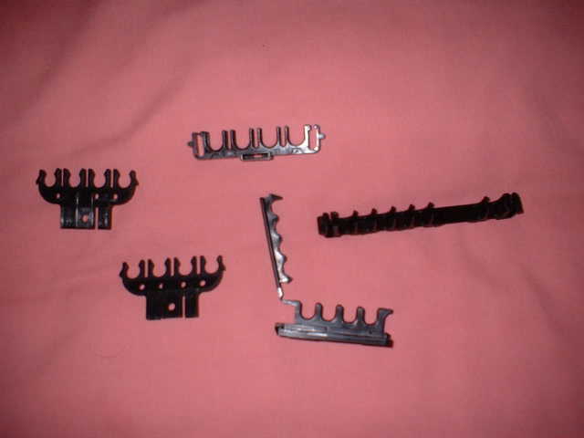

i've searched and found nothing. i am looking for part #'s for ALL the OEM wire looms for a 88' TPI engine. all of the wire looms just seemed to "magically" break all at once for some unknown reason? i don't want my pretty AC DELCO wires to fry. does anyone have part #'s or know where to get all of the looms(besides dealer)? i am also not looking for aftermarket looms. thanks people.

GM part number 12073948, Retainer Kit, about $6 per kit of five pieces of various design. I believe the AC/Delco part number is 8073 (for those few places that still stock AC/Delco over-the-counter parts). They clip to the metal tabs along the bottom of the heads and hold the wires in the factory position. I know that there is at least one kit sitting in customs in Liverpool right about now...

Hi Vader.
It isn't in Liverpool, it's on my car already! Arrived yesterday about noon, right through my letterbox!
Heres a photo of the contents for the uninformed!
Thanks again Vader.
Andy.
