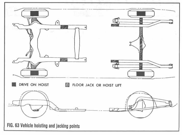

here ya go...

Great Thanks! If I might ask, Where did you get this photo? I have the haynes, but it does not show anything like this.
Thanks again!
Jim

i got it out of a chiltons manual. lol... first time it actually gave me some use. If you want a good manual, get the helms manual. It beats all others hands down.

That picture is also in the owners's manual..
