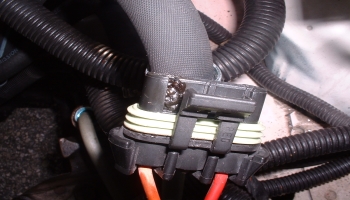

This is a connector between the fuel pump fuse and the positive battery cable, what would cause this? The plastic above the orange wire is melted.

Does anyone have any idea what may have caused this? I am pretty sure this is why my fuel pump is not coming on.

Obviously, the pump current is exceeding what the connections can deliver without heating. Is the fuse a 20A? IIRC, it should be 20A from the factory. If your pump is drawing more current as a result of the higher rail pressures, marginal connections may have suffered. Check the voltage on both sides of the fuseholder. You should find your answer there.
More current creates more heat. More heat creates more resistance. More resistance reduces the voltage. And lower voltage creates a higher current requirement to compensate. The effect is a cascade, until something fails. You're fortunate that only a connector failed. I believe you can get a new inline fuseholder to splice into the harness (soldered and sealed, of course).

Possible that the continuity is poor at the connector causing heating and melting the plastic housing.
With a very small file, clean the connectors. The will be some corrosion and melted plastic on the contacts of the connectors. You have to get it all out for metal-2-metal contact.

I am really starting to think that it is my fuel pump. I called the dealer about a relay and he told me most of them are the same part #. With this in mind, I switched the relay with another one that I knew was working, still nothing. I also cleaned up the metal connections on that melted connector and plugged it back in, still nothing. I think I know what melted that also, when I was putting the driver side valve cover on it hit the back bolt on the alternator a couple times (then I disconnected the battery) The wires that go to this connector go into the wire that goes to the alternator so I dont think that is the problem with the fuel pump. Like I said the fuel pump is only about 2 years old, but I did get it at Autozone. Is it possible that it is already shot? With the new cam and 24# svo injectors it is working harder but it only ran 2 days! This is killing me, I just got the car going and had my exhaust put on Thursday and this happened Friday.
