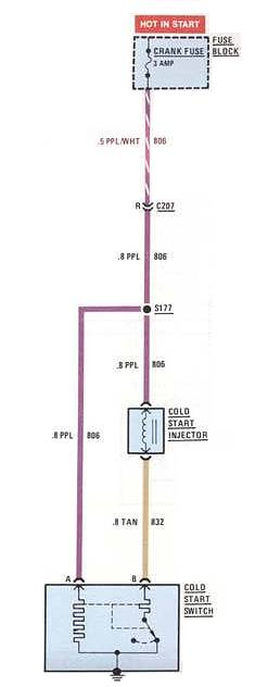

Your '87 TPI will have the cold start valve (injector) and control that enriches the starting mixture when teh engine is cold. If the injector or control are not working properly, cold starting will require a lot of cranking.
Your restart after heat soak is likely a different problem, however.
If the fuel rail pressure is rock steady after shutdown, that all but eliminates the possibilities of leaking injectors or pressure regulator. That may actually be an ignition problem, or something different. If you can test spark when you experience the hot no-start, you should be able to determine if the problem is ignition or fuel related.
Regarding the cold start system, there is a control unit located in the front coolant crossover of the intake base. This control will apply voltage to the cold start injector during cranking for an internally controlled time, and only when the coolant temperature is below 104°F.
It is the larger unit on the left side of the photo:
The circuit looks like this:

Hey Vader, NICE diagrams. Thanks! We checked the cold-start injector, it's working. And the car DOES start cold, it just has to be STONE cold. OR have been running less than 10 minutes ago. And it isn't that it DOESN"t start, but that takes quite a bit of cranking, or you step on the gas a bit. If the car has been sitting more than 10 minutes, or less than 24 hours, you turn the key and it cranks, and cranks, and cranks, and then starts. At least 5 seconds worth of crank. OR as you are cranking, you step on the gas. This will start it fine either cold or hot. It's almost like the computer has no idea of the temperature of the car is. 8 hours cold and 24 hours cold should be the same thing, right? The engine temp is gonna be at the ambient air temp, which is WELL below 104F in Colorado! Which is why we replaced the CTS. And BEFORE we replaced the FPR, the car ONLY had the problem 8 hours cold or more. Anything under 8 hours and the car would turn right over, no problem. So I KNOW the car WILL start under the right conditions. The fuel pressure is rock steady, the ignition systems tests out fine. We replaced the MAF also. IT's got 3 experienced mechanics at the local shop shaking their heads.
