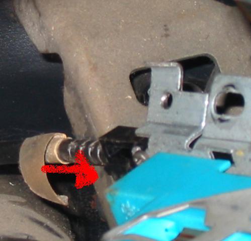

It took me a while to figure out how to get the cable out, but there is supposed to be a plastic tab on the side of the swich. You push that out and the cable is supposed to come out. Also make sure that you turn the ignition key and press the button on shifter. Because there is also a pin holding the cable in. Hope this can help you.

alright, so how do i keep the cable in the new switch?
Im gonna go look for the tab now
If i was looking for the tab while it was still mounted to the column where would it be ?

Should be located near the plug side.

I'm trying to attach a picture of where the tab is located. As for the new switch it look like it isn't made for that cable. Might be wrong switch?
