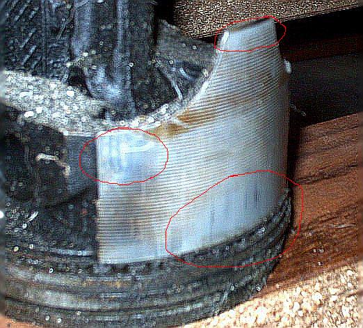

Yes they can be checked, but for what it probably costs to have that done, you can buy stock cast replacements for slightly more money.
A lot of discount places online sell them with rings for $50-$60. Heck... www.enginekits.com has hypereutectics (without rings) for ~$60.
I don't have a clue what it would cost to have them checked since I've never been able to reuse them. The block (cylinder walls) was always worn enough to need an overbore which requires new pistons.
Plus the skirts have always been too worn to justify buying new ones.
The circled areas are where the skirt is worn.
BTW, the other side is WORSE!!! It's almost completely smooth.
