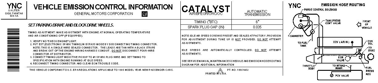

It's 6 BTDC, and your VECI label should have looked something like this:
