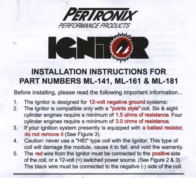

Well as it happens, I just did a Pertronix conversion on the Mallory YF distributor in my boat the other day, and I just happen to have the instructions handy. Amazing how these things work out sometimes!
Now keep in mind this is just one model, and may not apply to all of them, but it's at least something straight from the horse's mouth as it were.

lol...I don't have a scanner
I do have an old set of instructions though (may not pertain to this setup).
On the V8 conversion, I used switched power from ignition to bypass the resistor for startup only...i/e when it's running, it is running voltage through the ballast resistor.
On my 6cyl, I forgot one important point as to why I bypassed it...I still run a generator and couldn't keep enough voltage at idle to keep it working.
Glad this topic did come up, since I'm swapping to an Alt. on the '59 in a few weeks...probably saved me the cost and time of having to get new parts
