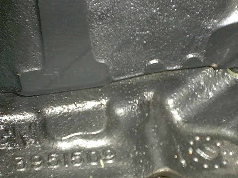

Drive it. Enjoy the power. There's nothing wrong with that casting, in fact it's by far the most common 400 casting. This one here, for example, has 125,000 of my miles on it, was just an old block dumped off in the trunk of a used car my late little brother bought, and it's still standard bore.
Just nod approvingly, pretend to agree, and move on. Some things in life aren't worth arguing about. If this person thinks that's a bad casting, well, in the long run that's a good thing, because that's just one less person competing to buy the finite number of them that exist.
