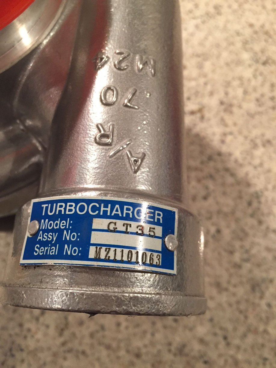

UPDATE:
My luck, the Canadian dollar has taken a SH*T fall right when I decided to take on a turbo build, parts are very much cheaper in the USA.
So I have been eye balling all the local classifieds daily looking for parts to complete my build. I was able to purchase a lightly used Dynamic EBL for less than half of new. I have decided to go with a 70mm and use my current stock 305 in the car, learn, tune and probably blow up before building a turbo friendly 350.
I found a Hybrid t3/4 turbo 70mm chi-knee knock off on a local site and the owner doesn't know much about as he got it with a bunch of other stuff that he purchased.
I would like to ask your opinion about this turbo ..too small ??
-The housing on the cold side has A/R 70 M24 ,
a/r 70 I assume is the cold side wheel, what is the M24 ?
Would anyone know what the a/r for the hot side be ?
How could I find this out ..? no other numbers or markings on the housing.
Thanks George

Nov 27, 2015 | 01:46 AM
Re: T76 on stock 350 TPI 5 spd
thats a gt3582
way to small for a single on a v8 that thing will prolly spool off idle , and choke around 4-4,500
its a t3 turbine
basically its the same turbo me and fasteddie ran on our 3.1L v6's
also it is the original design knockoff witht he tag rivited to the compressor outlet , longevity was not good at all on those units , sell it
edit
does it have water cooling ports on it ?
Reply 0

the turbo itself is known to burn up the bearings , those gt3582's witht he blue tag on the compressor outlet typically blow up within 100 miles
Reply 0
Nov 28, 2015 | 08:32 AM
Quote: the turbo itself is known to burn up the bearings , those gt3582's witht he blue tag on the compressor outlet typically blow up within 100 miles
Why?
Poor lubrication? Shafts break?

those blue tag units were the first design/copy something with them isnt right , the ones that were water cooled were the worst , they would always burn up the bearings in them ,
Reply 0
Dec 1, 2015 | 07:57 PM
  #43
Quote: those blue tag units were the first design/copy something with them isnt right , the ones that were water cooled were the worst , they would always burn up the bearings in them ,
I didn't buy it, Just noticed it in a local classified.
Thanks for the info '89, I'm going to stay far away from that one.
Reply 0
Dec 1, 2015 | 08:09 PM
  #44
if u notice the back of the turbine it doesnt look like it was ever balanced
put that thing on ebay , and buy a gt45 or one of the t4 76mm turbos
