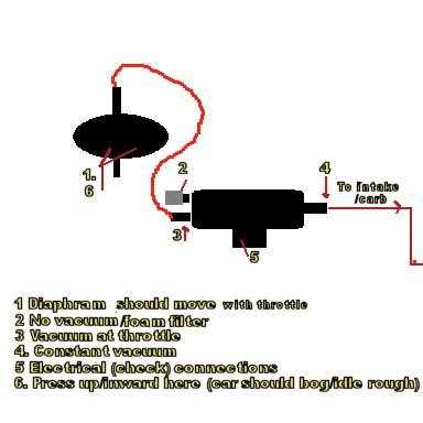

Old Sep 9, 2003 | 05:42 PM
lykan's Avatar
Joined: Jul 2003
Posts: 299
Ok here'
heres some suggestions to check your EGR.
Locate the EGR on the passenger side of your rig.
Take your fingers (maybe with gloves it gets hot). Reach underneath the egr, put your fingers up inside one of the holes in the egr, and press upward (inward), your car should start to idle rough and stumble, because your allowing too much exhaust into the intake.
If it does not idle rough, or stumble when you pull in on the EGR, it is likely that your passages may be plugged with carbon. Not allowing exhaust into the intake, this will cause detonation highe,r combustion temps,possibly a timing retard, taking away a bit of power, and increasing operating/combustion temps.
If it does stumble when you pull up on the EGR you can move on to checking it's function. Have somone press on the acclerator while you have your hand on the egr, if you feel it move up when the RPMS increase you know the valve is working.
If the EGR does not move when you hit the RPMS go up, check the vacuum hose attached to it, at idle you should feel no vacuum as you increase the rpms vacuum should appear and vacuum should intensify as the rmps go up, if you have vacuum to the EGR at part throttle, and the EGR diaphram doesn't move its most likely plugged with carbon and needs to be replaced or cleaned.
If you have no vaccum to the egr at part throttle, then check the solenoid, next in line. Check all the electrical connections. Check the opposite side of the solenoid, to make sure you have constant vacuum to it. If theres no vacuum going to the solenoid you found your problem, replace the hoses.
If you have vacuum going to the solenoid, but no vacuum when hitting the acellerator on the EGR side, you know somethings wrong with the solenoid itself.
33-vaccum to low I belive this is possibly caused from a bad egr system, if the EGR is stuck open it basically is a HUGE vacuum leak.
32- Check everything related to the EGR
I hope this helps you out, attached apitcutre so you can check out if its connected right, and see what I am talking about
