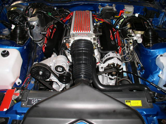

I think it turned out OK. Here's a picture...the "taped" fittings are down low on the driver's side, certainly not the focus of attention:
