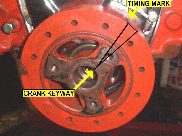

The distance between the two radii should be 7/10", half an inch is fine.
