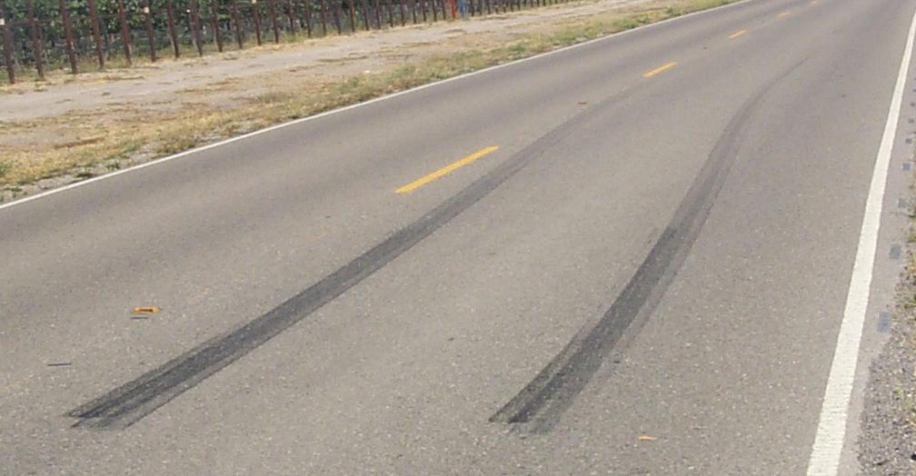

I was just about to pull the SR nut decided to start it and test it one more time. It looks like the other Maf was the starting problem. The tick is gone and this is what was left after the test lauch. Looks like it's working fine right now.
