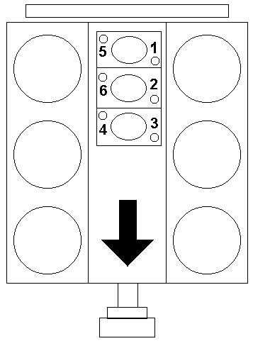

I know this will probably get locked but I have no where else to turn. I have a 97 E-150 work van with a 4.2 V-6 in it, I mixed up the plug wires and can't figure them out. does anybody know the firing order of this motor and if possible, which port on the coil pack each one goes to.

i'm almost posisitve but i think the order is:
1-4-2-5-3-6
my dad use to have one.
as for the coil pack, sorry =[

Originally begged by 1986redbird
MODS, PLEASE DON'T LOCK THIS, you are my last hope before taking it to a shop !!!!!
Obviously, you're not trying very hard. I found this in less than 30 seconds:
http://www.f150online.com/forums/arc...c/85596-1.html
Anyway, you know the rules. A Ford isn't worth our bandwidth.
