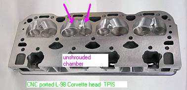

You do not need to "chamfer" the cylinders.
The area where the cylinder is closest to the valve is a very low flow area. Don't waste your time. If you want to improve the airflow into the chamber then work on the area right near the spark plug. This is a high flow area and responds well to deshrouding.
Get a garden hose and squirt some water through the intake port and watch the water as it leaves the port. You'll see what I mean.
Look at these CNC ported L-98 heads. You'll see whare they are reworked.
Use flat top pistons. Forged is a good idea for a Squeezed motor. get the deck height and quench area right before you worry about shaving the head.
