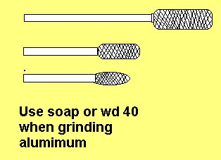

here are the three shapes I use
search my past posts on porting 416's its all there.
