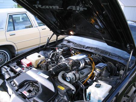

I wouldn't put them inside an interior, they get pretty hot. Here's where I mounted mine infront of my windsheild washer tank...

and mine is on the opposite side of tunedport 335's
