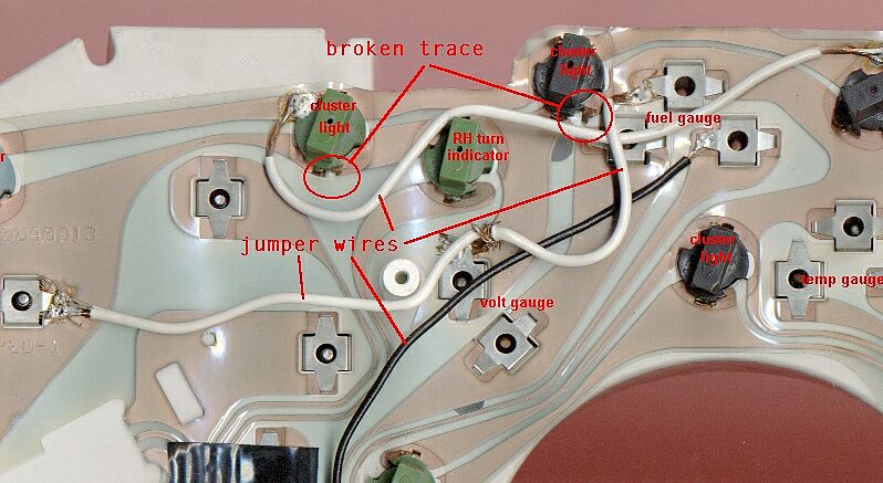

There is either a bad ground connection to your cluster, or one of the circuit 'traces' on the backside of the cluster is broken...it sounds more like the latter.
Below is how I repaired the cluster from my Z28. Not pretty, but it works.
