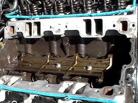

Slightly SHORTER actually. the V6 lifters, although shorter than the V8 roller lifters, are TALLER than the standard flat tappet lifters by about .3-.4" If i remember right.
I will be re-using my old pushrods though, simply because they were a little too short to begin with.
and Just an update, Today I finished the "retro fit" part of this swap. Clearanced block for dog bones, and drilled/tapped for spider tray.
Turns out, I never even drilled through the oil galley in the center of the block. I only tapped about .25" down, then cut the end off of a TAP, and threaded it in. then I ran a nut down on a stud, and bolted the stud into the block using the nut to tighten it very LIGHTLY. to finish it and make sure it never moved, I used a Nickel99 Cast rod to TACK weld the nut to the block, with a pre-heat using an Oxy/Acd torch. came out... perfectly. have pics tommarow...

Just so everyone knows I think Guido is right about some aspects, cutting up the block isnt a great idea to begin with. But in response to his "hack job" position, I think that there are other ways to do this retro-fit without cutting up the block, or whatever. For instance what If i just clearanced the dog-bones to clear the water jackets, instead of grinding on the block? then all thats left is how to mount the spider. that certainly was no hack job, the holes in the oil galley never broke through, and all went as I planned it to. Even the pinhole I created in the water jacket finnaly welded up just fine, I wound up removeing the JB weld and using a much larger rod and a bigger welder to get some real penetration, and it worked out just fine. NO the rotating assembly was NOT in the motor when I did it, but the motor was in the car so i could test fit turbo manifolds while I did the retro-fit at the same time.
And i saved $500 in retro fit roller lifters. This WHOLE PROJECT including retro-fit roller cam, and Twin Turbos is costing me less than $1000, why should I spend half of that on lifters? It makes no sense to me, not for a car worth less than $3000 to begin with. Who cares if the motor gets junked? Its just a crappy 4-bolt truck block from 70'something. I can have it ripped apart and rebuilt into a new block in 4-5 days if it fails. And just for reference, If i was going to spend $500 on lifters, i would rather spend $500 on a nice machined clean roller block instead, and just bolt my stuff into it. spending $500 on the lifters just makes NO sense whatsoever.

Haven't tried it out yet
I'm not sure what you mean about the shims and washers part, anesthes??
The lifter bore height difference is the whole reason for getting the shorter 3.1 V6 lifters to begin with.

Actually, if you do a mock assembly using a std base circle cam, in a non roller block, with a factory lifter. You'll see the oil channel in the lifter extends past the top of the lifter bores.
That's one reason you can't use a V8 lifter in a V8 non roller block.

Originally posted by FAQman
Or you get 8 sets of V6 rollers, a V8 retainer plate, a bit of drilling for the retainer plate mounting studs and reworking of the lifter boss tops and presto, damn cheap factory like roller setup.
Someone just referred me to this post, and hey presto, there's a pic of my 383 in the 5th posting!!!
For anyone considering doing this, I have about 3000 hard miles on this engine now with no issues. That 3000 miles includes about 20 dragstrip passes also.
I have had the manifold off once for an inspection, and all is well.
In the next 3 weeks I wil be doing a cam swap also, but i don't expect to find any problems, car ran its best 1/4mile to date just last week (12.8 secs at 3000ft = 12.44 corrected to sealevel)
Ben.
Ben.
Well I think some people are missing the point. There is no doubt that this mod will work, it has been proven without a doubt to work already.
The point is, that there is a chance it WONT work. As in, you ruin / waste your motor because of it. For me, it didnt work. I mean, it worked as in the motor RAN, but it didnt "work" because I had oiling issues, a crack in the block, and JB weld in places it shouldnt be because of this mod.
The real question is, is it worth the $300-$400 you save to possibly ruin a $2000-$8000 motor in the process? I think thats what some people (at least I) are trying to say.

Anyone following this post will be aware that there are risks by now, and hopefully know to be extra careful.
Using this part, can reduce the risk of grinding through in the lifter valley.
http://www.sdpc2000.com/cart.asp?act...514&pid=210398
It's too bad your engine ended up being the example of what happens when you grind too far, KingtalOn... Not trying to be rude or anything like that. And I'm glad that your turbo was successful too.
I think that when precautions are taken, and if a builder is aware of the potential risks, it isn't a bad choice.
Personally, I'm glad to see some testimonials on that retrofit, both positive and negative.
I think that a good strategy for the 3.1l lifter retrofit would be to do the grinding, before getting any other machine work done.
