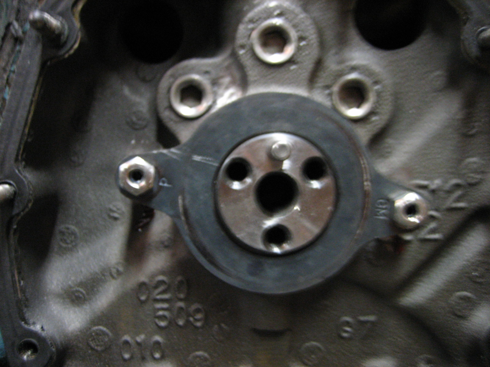

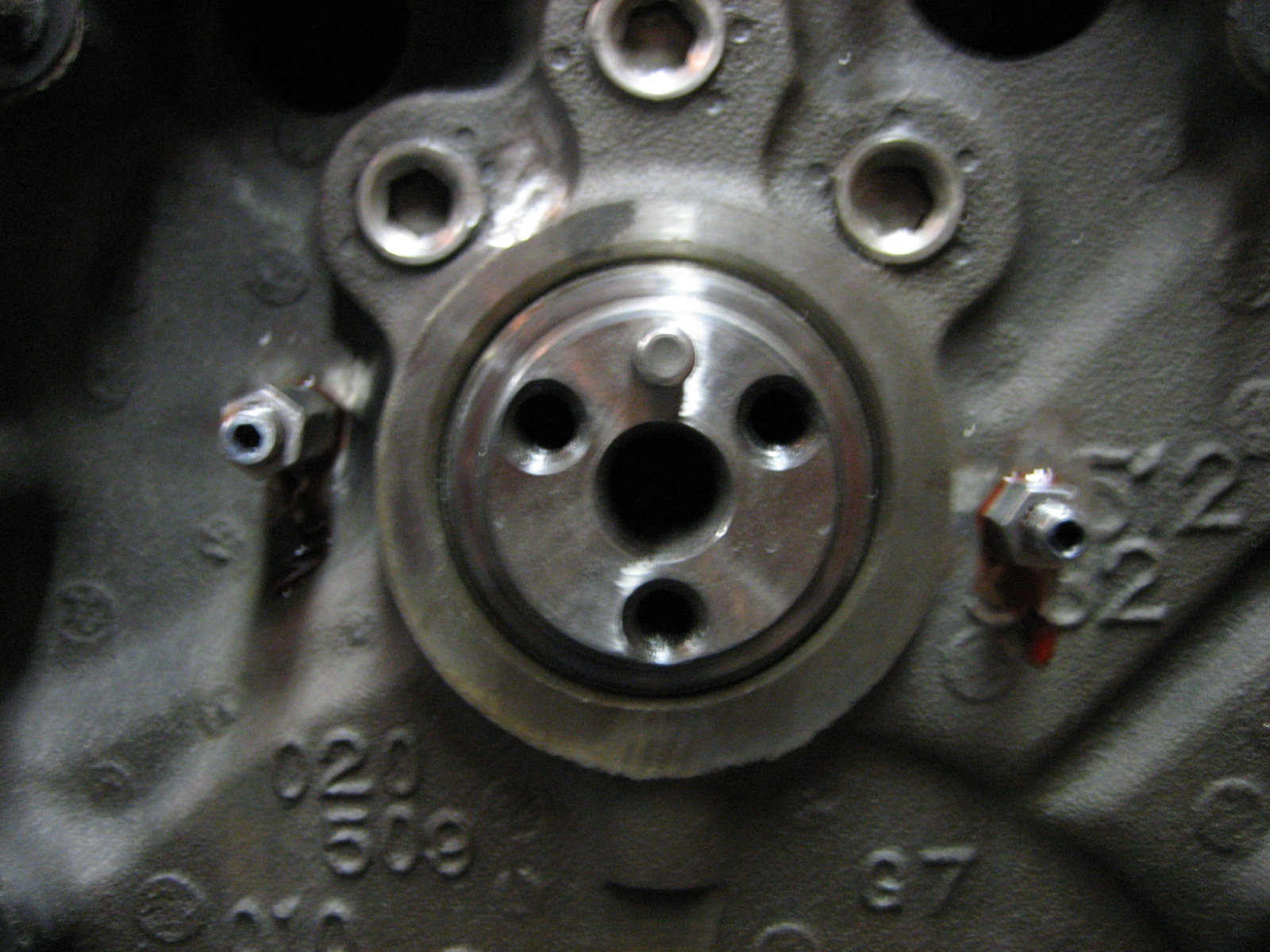

For those of you guys Brave enough or Crazy enough here's what i did.I bought a cam from LPE and they only sell a cam with the snout set up for a factory roller block.
Not being a big fan of the "Cam Buttons" i decided to take it to the next level and use the Factory Cam Thrust Plate which i spent $8.00 and about another $5.00 in hardware consisting of hardened allen studs and hardened steel self locking nuts and some barrel nuts, and of course Locktite Red.
The studs need to extend no more than .300 of an inch after you get the studs mounted and the barrel nuts so that everything is level with the block where the cam plate sits against must be perfectly flat.
I drilled through the block to mount the studs into the water jacket.
The general idea was to have the studs lock tighted to the block and the barrel nuts double lock the studs and provide the surface for the cam thrust plate to set against.
Pictures enclosed.

Did you complete it?
I have a block that I wanted to try the same thing on. V6 lifters and all.
Some of the guys say it's crazy to do it that way, but like you said, "For those of you brave or crazy enough"
Anyhow, I have all the parts except for the pushrods. What did you do about that?
Thanks

i sent you a message, the pictures were too big for the server.
My e-mail is drb930@netzero.net
Send me an e-mail and i will send you the pictures.
Pictures enclosed.
Pictures enclosed.

Please remember to shorten the dowel pin on that LPE Camshaft if you intend to run a steel timing cover.
If you don't it will hit the cover and you will have to shorten it after it is all put together like i had to do.

I guess I'll bring this thread back from the dead. Is anyone using this successfully since some time has passed?
I have the plastic pieces that replace the dog bones, they cost 30 bucks for the pair after shipping from Scoggin Dickey. This engine will however get metal dog bones, its not mine and the owner wants metal rather than plastic. I'll save the plastic's for my 406 later.
The plastic links do require less block grinding than the metal dogbones. I have this block currently fitting both types. You can save A LOT of block grinding by taking most of it from the dogbones. The amount of metal removed from the block gives me absolutely no concern. I used a dremel with several different bits, and a little from a die grinder, but the whole thing can be done with the dremel.
I can clearly see how easy it would be for somebody to get carried away and go too far, so check frequently for minimum clearance.
I still havent got to the cam retainer plate yet but I'm going to do it similar to DRB930. The biggest difference in the way that I'm doing it is that I'm holding the spider down with metal tabs that push down from the heads. No need to drill in the valley.
