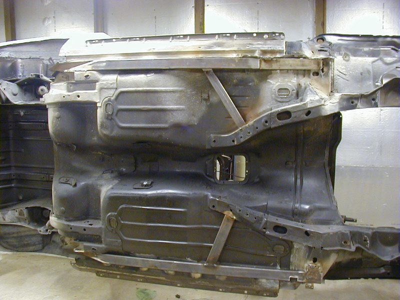

You absolutely need to stiffen the body. These cars are missing a vital component that should have been included from the factory; namely, subframe connectors. You need them, especially if the car has T-tops. Get some of the type that run all the way along the sides under the rocker panels, and then go across to the inside and connect to the front subframe.
I have Spohn LCA lowering brackets (also correct a factory defect with these cars, faulty rear suspension geometry); Lakewood lower control arms; and a Spohn torque arm. This combo gave me a massive improvement over the rubbery stock stuff. In fact, when I took off the factory LCAs, one of them was visibly balooned out, and I could flex both of them with my hands (the one more than the other obviously). This seemed to hook up a moderately warm 400/5-speed pretty well.
Here's a pic of somebody's car unibody with some kind of SFCs that are a good example of what to look for. These particular ones are somewhat exhaust-hostile; but the overall principle is correct.

RB you would have a picture of a unibody laying on its side. Yea stiffen up that body. Nice engine setup you have there, remember to post pics of everything when you get a chance.
