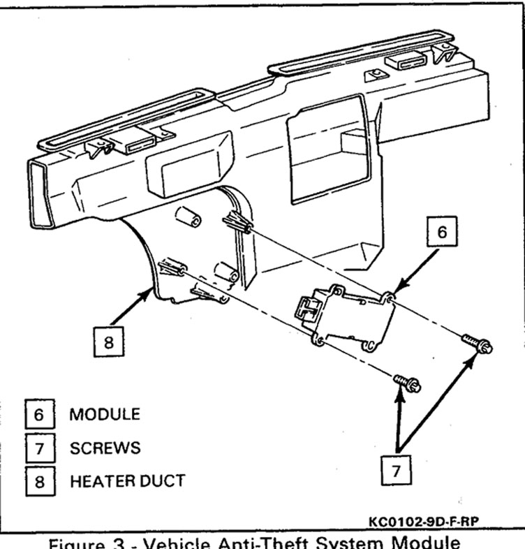

Old Apr 4, 2004 | 02:38 PM
Trickster's Avatar
Posts: 6,127
Likes: 12
From: conway, s.c.
Car: 1989 Iroc-Z
Engine: 5.7L TPI
here's a pic! It is actually under the vent on the drivers side. I think what you are talking about onebinky is the cruise control module. It is located under the dash on the passenger side 1/2 way between the A/C control and the ECM.

Hey guys I really cant find that Module. I've looked all over for it. What does it look like? What needs to be taken off in order to get to it? That picture is confusing, I don't recognize any of that in my car. I pulled off something that I thought was it, but I don't think it is....It's a 3X5 white box containing a circuit chip or whatever inside, it was located to the left side of the passenger side of the dash. I'm thinking that it can't be it. Someone please help. I've taken apart the bottom plate under steering wheel, the center panel for radio, the a/c control, and the passenger side (under part). Exactly where and what am I looking for. Thanks.
That box is probably the VSS buffer, did it have a label with '4 OUT' on it?
Looking at the Trickster's pic to the right is the firewall. Yep, box is between the defrost duct and the firewall. Easiest way to get to it is to remove the windshield and come down from the top.

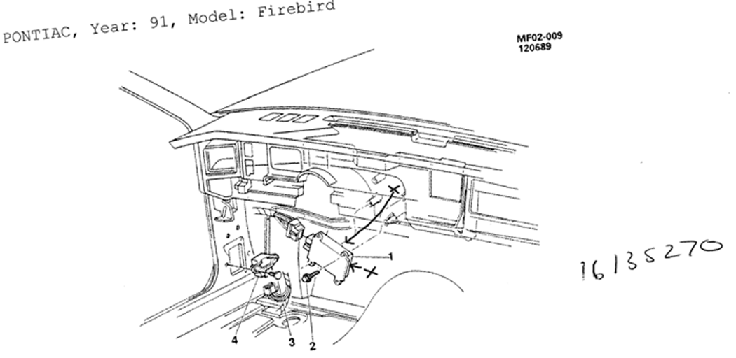

Hello Gunz4life2,
I previously posted a picture showing the location of the VATS module. It was from a 89 camaro, although the location is basically the same. You may be confused by the lack of detail. Here is a picture from the GM parts catalog for a 91 firebird showing its location with a lot more detail. The part number is also included with it in the lower right hand corner. If you cannot see it when you look in there, it is because it is on the firewall under the vents and behind the center console air vent box. You don't have to pull the windshield to get to it. APRIL FOOL'S day is over and done with. Also notice, it is on the drivers side. not the passenger side.
Ah, but I didn't say that he had to pull the windshield out. Already having had to remove this box from a f-body I know what he is up against.
