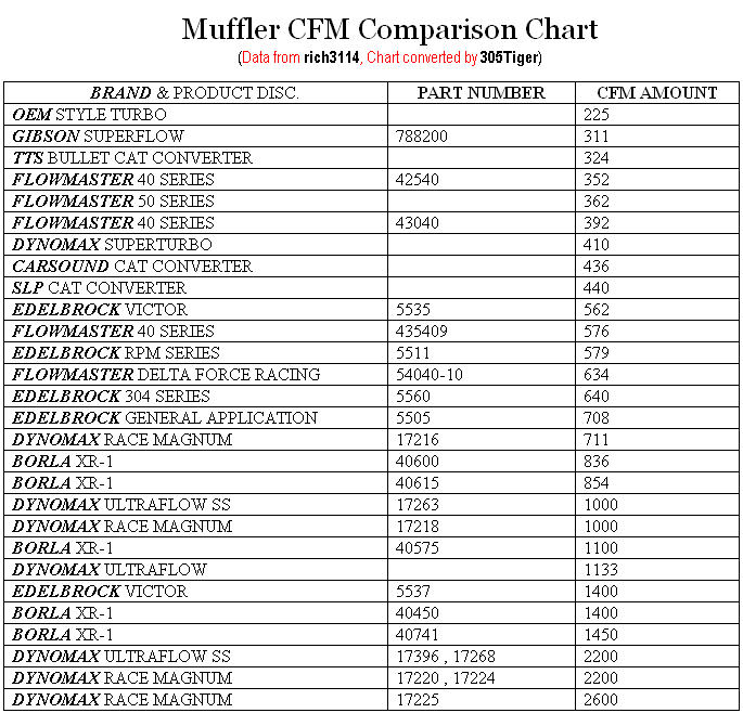

Muffler CFM Comparison Chart
Hopefully this will help someone out in one way or another.
-G
Attached Thumbnails Muffler CFM Comparison Chart-mufflercfmcomparisongif.gif

Cool!
Might be a good idea to put this with.. uhh... i dont remember who's... header comparison chart. Its in the FAQ board.

So basically, for street apps, the Borla race takes the cake. Id like to see how Spintech fits in as well as Magnaflow and Hooker. But great chart.
