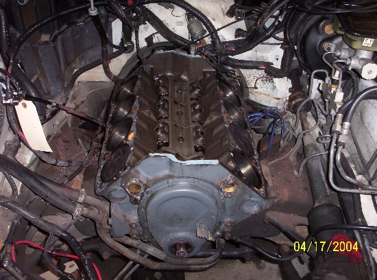

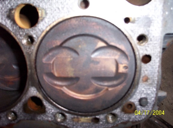

I took the heads and all the AIR lines off yesterday along with the headers in preparation for my new Trick Flow heads and Hotcam to go on. BTW-LT1 intake from John will be used also. Anyway, here's a couple pics. Does everything look normal here? Like a L98 should after taking the heads off, no cleaning done. And should I clean the top of the pistons,or do they look OK? Thanks.

Good view of pistons.

Closeup of piston.

BTW- See in the first pic, the cylindrical part on the back of the block with the brass fittings attaching it to the block and the wire going to it. Anyone know what this is and what it does? Thanks again.
I think that may be your oil pressure sending unit?
Old Apr 18, 2004 | 12:13 PM
formularpm's Avatar
Joined: Sep 2002
Posts: 988
Likes: 57
From: Nebraska
Car: '89 Formula
Engine: 355
Axle/Gears: 9 bolt
Your stock oil pressure sender should be located right above the oil filter. Do you have an auxillary gauge? Whatever that is is plugged into the oil galley. As for the pistons, I wouldnt bother cleaning them, they look okay. If you do, do not use Scotchbrite pads.
Not in all years. Some have it right where his is.

I did almost the same, tfs heads and lt1 intake but I went with a comp cam. Your pistons look a little cleaner than mine at 48000 so I would just leave them alone. I went ahead a bought a new timing set when I did mine and since I raised the engine to do the cam swap I changed the pan gasket and cleaned the inside of the oil pan. so you might want to think about that. On my old 89 I put my aftermarket gauge in and used the same sending unit in the same place as shone in addition to the factory unit.
