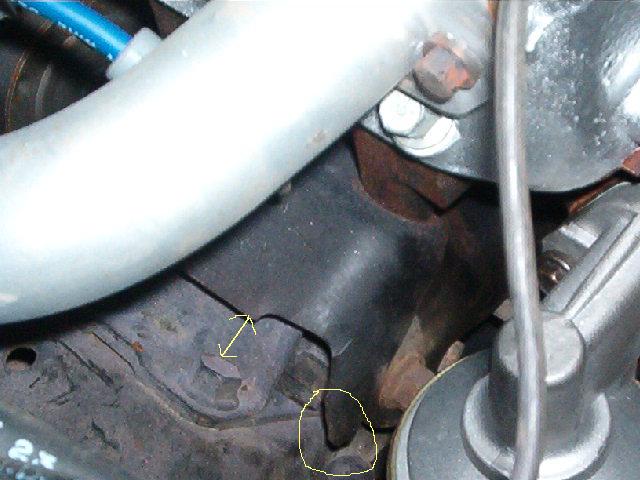

Yes, I am using a stock 400 balancer and a 305 flexplate with a counterweight that bolts between the flexplate and the crank…..
I just went out to look around and see if I could see anything different with the crank pulley or anything else and I think I may have found something…….The motor mounts! The right side (Pass.) Is lower then the left side (drivers) now if I am thinking right when the motor torques the left side goes up and the right side would go down right? If so then I think my right side motor mount is bottomed out.
Here are some picks I took…..
Right side (Pass.)
What do you guys think?? Motor mounts bad?

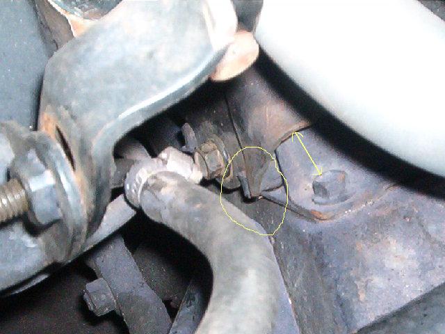

Left side (Drivers side)
