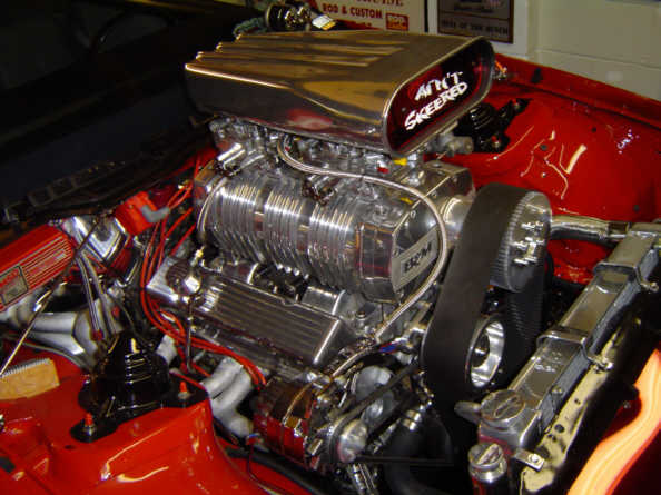

Hi, I'd just like to say that I love my 91 Firebird with the LO3 TBI. It has over 150,000 miles on it, doesn't burn a drop of oil, and actually runs much better after the 10,000 troublefree miles I've put on it (bought it last fall, and I drive a lot for work). My auto trans was rebuilt by previous owner, and the motor seems as though it was rebuilt too, but I think it's original.
Even so, my TBI car always starts up and runs reliably, no flooding or anything else. I run high octane gas, and throw in a bottle of Berryman's fuel injector cleaner once in a while. My open air element gives a nice whistling induction sound, and my Flowmaster cat rumbles nicely.
No, it's not a 12 second car, but fast enough to put a smile on my face, winding up smooth with power to redline.
Sure, you always want more power, so down the road I plan to drop in a 310hp 350 crate motor, which is compatible with my ECM, TBI and all accessories. I will need bigger injectors, a new fuel pump and a chip.
There are several engine builders that make performance replacement motors specifically for third gen TBI F-bodies. So, while the bulk of guys with fast cars might be running TPI, there are definitely performance options for TBI as well. A TBI crate motor, with headers, ignition upgrades, and other tweaks would be plenty fast. And you should still be able to pass smog.
To sum up, my car came with TBI, (and a GTA body kit), so I'd rather stick with that system instead of changing everything for a TPI motor with the same performance. Already, my TBI car is lots of fun as is, no complaints.
"One of the things we KNOWS is, it's not how you stand by your car, it's how you RACE your car, you better learn that."
-sage words from "Fast And The Furious"
Son Of Toretto
P.S. This setup would be nice...can you use TBI's with one of these suckers? Still use the ECM? Ultimately, I'd like to have a huge blower poking out my hood, pumping 800+ ponies. You gotta dream big...
P.S.S. Just read my post, and realized I'm a TBI freak...
