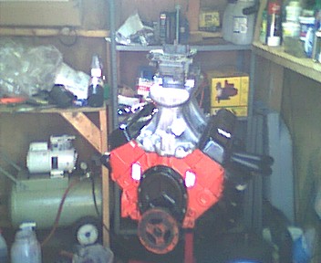

I've seen some aftermarket TBI TBs and Manifolds and I guarentee that one of those setups, on a healthy longblock, could support some serious power! Like a few others have said...it is chip tuning that makes or breaks it.
I had my 355TPI motor with 9.5:1, a compucam (214/224, .480 .480, i think), sportsman II heads, edelbrock base, siamesed runners, freemods and so on BUT didn't have a custom chip. Guess what...IT SUCKED! I swear that it ran slower than the stock setup did. I dropped a carb on it...nothing else...and it livened right up (just no more super-duper seat of pants low-end
). With that carb i eliminated the whole chip process and it let me tune the motor to where it needed to be!
I think that one of those 4bbl throttle-body setups with MPFI would be the bomb-diggity-sheeit...hook it up to a laptop and its a digital carb!
