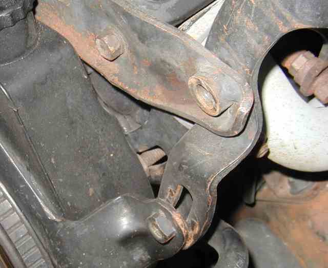

Ok its been a while since ive had my AC in the car so i really need a layout of how the bracket assembly goes. does anyone have any pics of it? its a pully assembly off of an 82 camaro so its all V belt basicly i just need to know how the brackets sit for the AC and the Pwr steering pump because they are both on the same side. once i got that under control everything should be good.

This one goes on first...
Attached Thumbnails AC pully assembly NEED HELP ASAP-lower-bracket-front.jpg

Looks like this from the side.
Attached Thumbnails AC pully assembly NEED HELP ASAP-front-upper-side-view.jpg

The upper A/C bracket goes on top of the front PS bracket.
