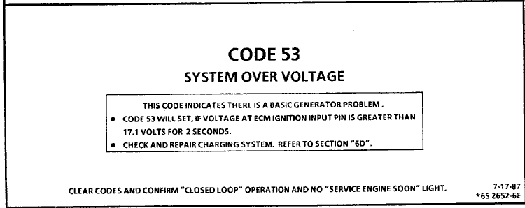

Yes, it means that you have an overvoltage problem, Take your alternator and have it checked at your local auto parts store. I would also have the battery checked at the same time.

Check your wiring for the battery and also the power leads going to the ECM. Even though you had the battery and alternator tested, you are still getting a power spike from somewhere occassionally. Also check your fusible link from the alternator to the battery and the one to the starter solenoid.
