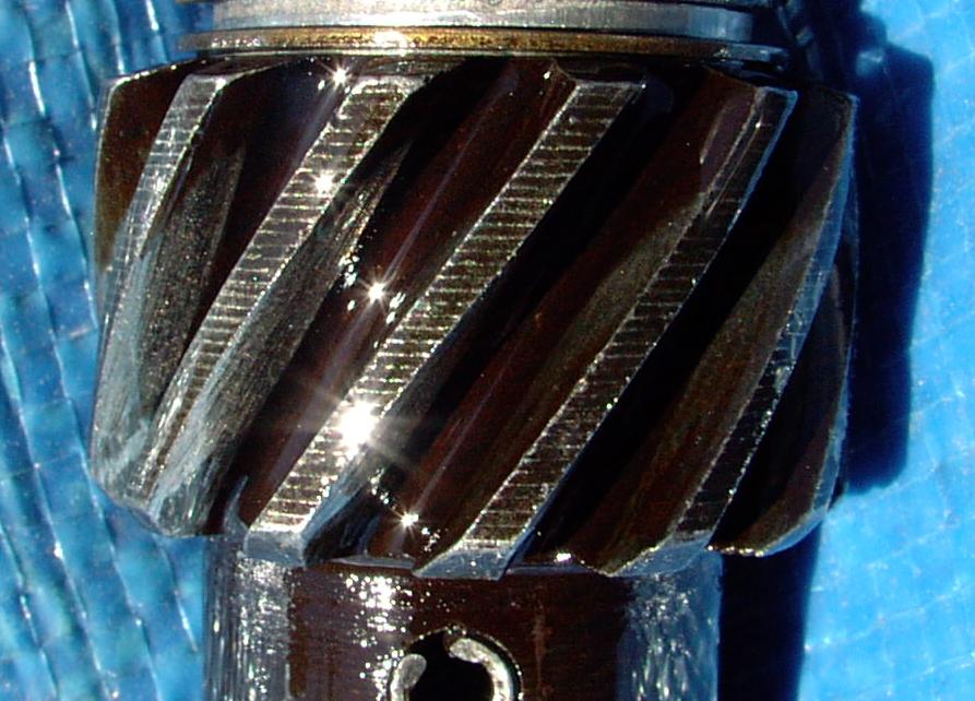

I pulled out the distributor to make sure that it is wearing correctly only to find premature wear. As seen in the pic, the wear is similar on all teeth (right side). I did not check the distributor shaft or oil pump shaft for straightness, but visually I did not see anything odd about their appearance.

Here is the pic.
Attached Thumbnails ARGH!!  Second distributor/cam gear wearing out fast!  HALP!-dist-damage1.jpg

The distributor appears to be sitting too high. If it is difficult to get into the manifold hole, that may be your hint.

This distributor has worked for years in this engine. Also the photo is a bit deceptive for when I look at the wear pattern, it is within the center of the gear teeth.
I looked at the distributor a little closer and found what was causing the distributor not to "fall into place". The outer adjacent side to the mating surface of the intake manifold and distributor was rubbing against the intake manifold, so I ground some of the distributor that was contacting and now it installs with no effort.
Now only a little of distributor housing was contacting the intake manifold and it was not difficult to install the distributor, it just took a little force and a slight twist. I don't believe that removing a couple of 0.010" will fix the problem.
A closer look at the wear pattern of the distributor gear reviles that one side has worn more than the other, so I'll set up a dial indicator to measure untruness.

Anyway, looks like there are two wear patterns on that gear, if the photo can be trusted.
Bronze gears are expected to wear out and be replaced often (remember, we're talking about race car engines with that combo).
Melonized won't help if you've got a set-up problem.

Upon further inspection I found the distributor shaft and the bottom bore of the distributor had a lot of wear (about 0.025" play). So replacing just the distributor gear was not enough.
Hopefully this other distributor with 0.007" of play will take care of the problem. [/fingers crossed]
