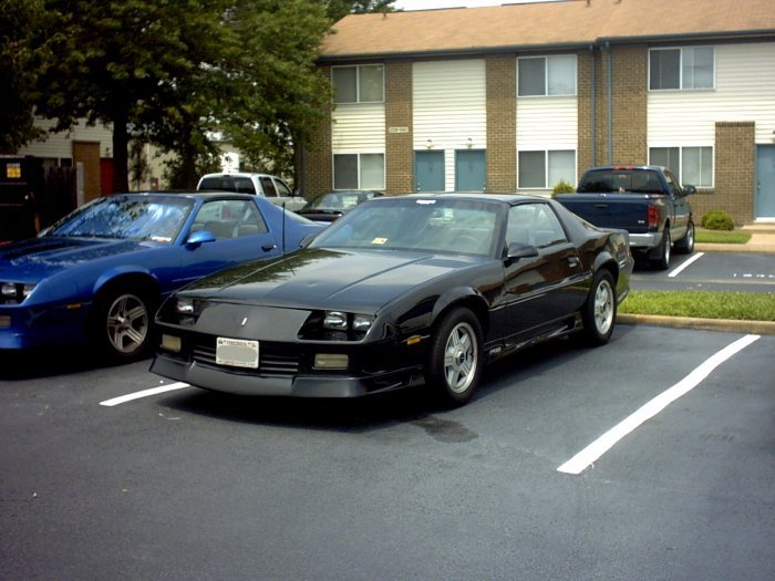

Here's the pic I just took of that RS I'm selling, and that's my IROC and where it will be sitting for quite some time. :/
Hopefully the RS will turn into a new engine for the IROC soon.
Old Jul 14, 2004 | 11:50 AM
Steven89Iroc's Avatar
Posts: 701
From: College Park, MD
duh, here's pic...
Attached Thumbnails Hydro-locked-92-rs-7-14

Originally posted by Steven89Iroc
duh, here's pic...
oops.
theres a dent in the hood.
i'll give ya $1000 for it.

lol, nice looking car though. Good paint. My car is in perfect shape except for the paint (really bad fading) and a dent in the driver's door under the mirror from when some girl in a Toyota RAV4 backed up into my mirror in a parking lot!
In any case, very nice car and the wheels look in good shape. I say you swap those wheels onto your Z; they look cooler
I see T-tops too!
That answer is still no.
The paint is okay, but not perfect. There's also some other dents in it from when the previous owner had it and someone backed into it, but they aren't terribly bad. Yeah, it has T-tops.
As for the wheels, my old IROC actually had '92 wheels on it and I really liked that look. I like them better as well, but they aren't going on the IROC because I have some '97 C5 wheels waiting to go on. They are all front 17's because I don't like the staggered look. Here's the kicker... I only have three right now because FedEx LOST a WHOLE FRIKIN WHEEL AND TIRE. That's a whole different story though, I'm going through that BS as well. Those wheels won't be on for a long time now.
