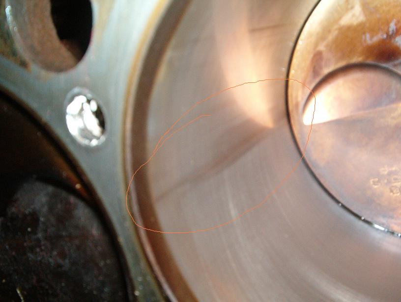

Old Jul 20, 2004 | 05:58 PM

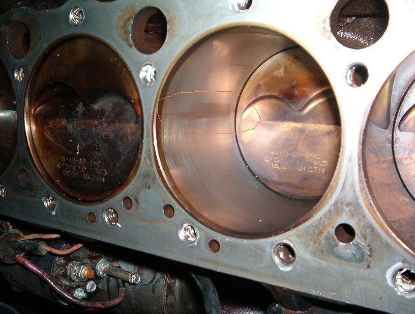

Update.......
I took the head off today to see what I had and here are some pictures........ The only thing I found that look different was that mark in the wall but you can still see the cross hatch pattern in the cylinder wall so I don't think anything bad happened but I just want some more opinions...... I am going to call my builder in the morning and I need to know what would have caused this to happen? Was it install error or was it just a bad day?? Any input here would help so I have something to stand on when I call
