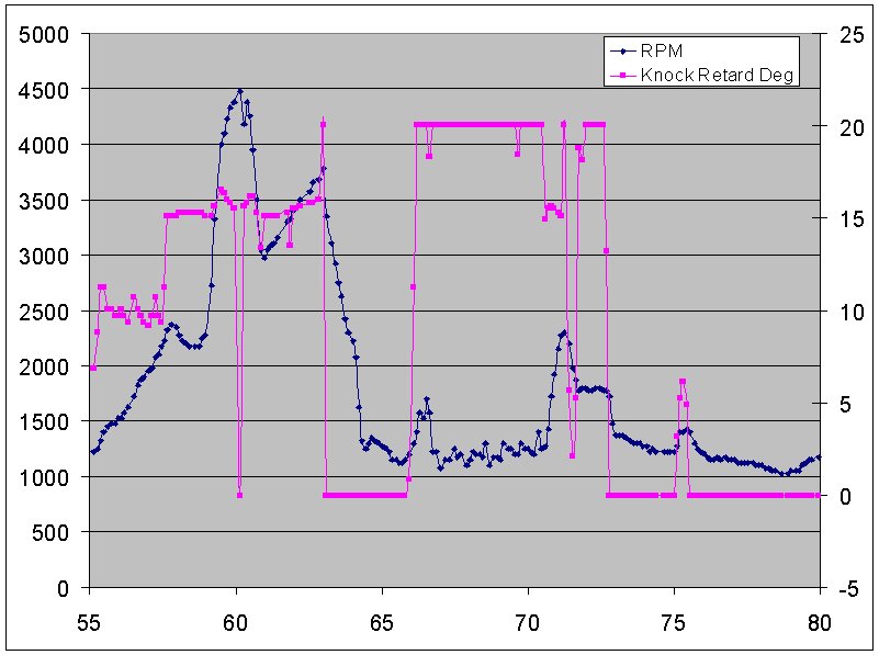

Anyways, here's a log of a run from a stop sign at high throttle to about 60, then I drop down to the 40's and allow 4th gear and lockup. That's when the problem starts happening. You can see it in the fluctuations in the mph and rpm. It occurs during that 5 second interval that the TCC is locked up. There are some crazy contrasts between that region and just before and after it in knock retard, pulse width, MAP, and other things. I think someone more experienced than me would see something very wrong here.
The log is in Moates format with .csv extension. I can make it Excel if necessary. The important log items are in the HO-IO columns region, but everything's there if it helps.

Yeah I did. I bet it has something to do with the HUGE amount of knock retard you have. Get that taken care of and your car will probably drive alot better.
It also looks like you're having to put a lot of throttle into it just to cruise aka 40% throttle. I "think" that's due to the knock retard.
Are you running cheap gas? Do you have an aftermarket chip in there? Something is causing lots of knocks.
Here is a chart from your data. Knock retard in Degrees is in pink. Blue is RPM

Yeah I was seeing the same thing...but not sure what to think of it. It's possible that my ESC system really is messed up and is causing the weird knock retard.
As for the amount of throttle, that really is not a factor. Notice I was speeding up in 4th gear, low rpms....I know my tranny well enough to know how much throttle I can put before it downshifts. Basically, I was pushing the car into this "shudder" is thoroughly as I could to get a good reading.
I run 91 octane, but I could have gotten a bad batch of gas, I've heard of that happening, and people pull their hair out and the problem goes away with a new tank of gas, but would I see this ONLY in this region if it was bad gas?
As for the chip, it is stock tables with things like EGR, AIR, VATs disabled, so it's not that. If I had an AutoProm, I'd burn it to avoid the knock retard, but it's clear that would be treating the symptoms and not the problem.
There's not much gas left in it....I'll go around in D and try to run most of it though, and get a new tank. I know I can avoid the region if I absolutely have to. Also, I'll thoroughly go through the Helms manual flowchart for the code 43.
Something of note, though, that I would definitely like opinions on: You said that something is causing lots of knocks there.....yet my knock count is the same throughout the entire log....what does this mean?

Yeah, I was noticing that the knock counts were steady but it kept pulling timing. Not sure how to explain that. I didn't realize you were trying to put that much throttle into it I thought you were just cruising under light throttle. I was asking about the gas and chip because many of the off the shelf chips just bump up timing which when mixed with low octane gas could hurt you.
I agree that it does look like something is messed up for it to be showing that much timing being pulled. Maybe someone else can chime in on it.
