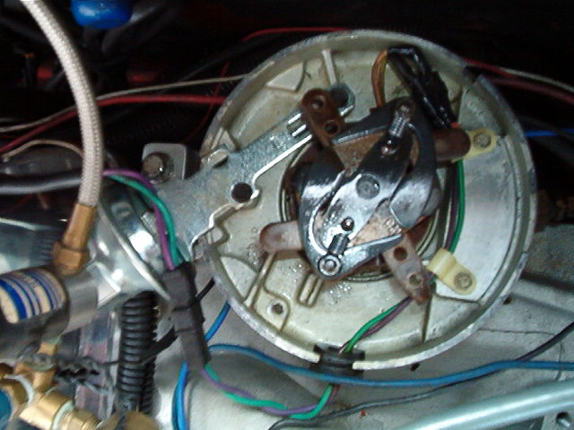

The only stock HEI parts is the ditributor and the pickup coil...The coil is a ACCEL-the stock 4 pin module replace by a MSD 6AL.
Old Aug 6, 2004 | 10:41 PM
ljnowell's Avatar
Joined: Mar 2004
Posts: 3,935
damn, you are actually using the aftermarket weights?
Old Aug 6, 2004 | 10:48 PM
smoktire's Avatar
Joined: Feb 2004
Posts: 150
From: Canada Quebec
Car: 88 camaro
Engine: L69 305
Transmission: TH350 3000stall
Yes they came from a MOROSO kit.
