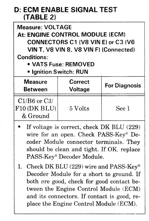

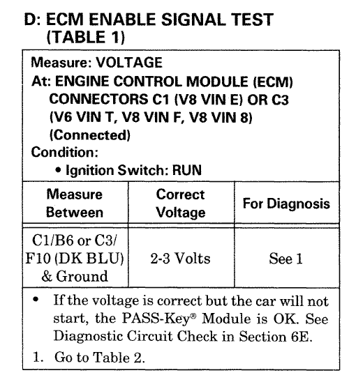

You would be correct in assuming that you would still have the problem. I have included the ECM test for the VATS system. On your car, the wire to test would be the Dark blue wire going to pin L of connector C207 and from there it goes to pin "F10" of the ECM. And lastly, yes you can bypass the VATS entirely but not until you get this problem fixed. BTW, pin "F10" is the cranking fuel enable signal on the ECM.

page 2 BTW, I think what DENN_SHAH & SMasterson who posted above my two posts here are talking about is the INJECTOR drivers in the ECM failing.
