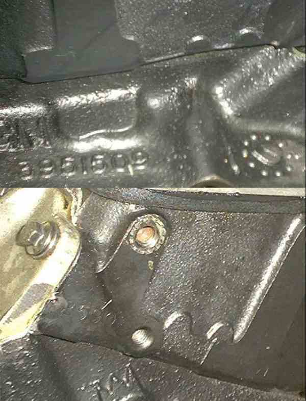

Here's what double-humps look like. Note the double hump on the casting mark, which is considerably different from the markings on smoggers. This set is the 69-70 ones with the accessory bolt holes, which are relatively uncommon; seems like everybody and his brother has a set of the older 461s and the like, without the bolt holes. You don't want any of those either, even though they're REAL CHEAP; the reason they're cheap, is because nobody can use them, they don't fit any cars made in the last 30 years.
