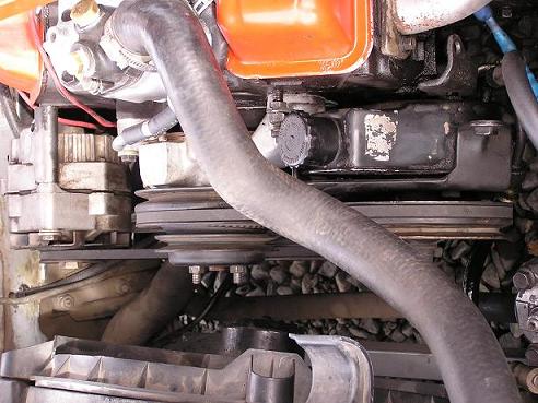

If you switch over to a V belt you can make a stout bracket for the power steering quite easily. This is what I did. I have headers and didn't want to mess around with the hokey bracketry that has to be purchased seperately. I made it out of a piece of 1/2" by 1" 304 grade SS flat stock. and I had to make 2 bushings, one is visible out front down low between the pump bracket and the SS bracket, it is 1 inch thick, the second one is just above the pump fill cap in the pick between the block and the upper pump bracket, it is 3/4 inch thick.
You don't have to use SS. Regular iron would be fine, just paint it.
This is just a suggestion if you want to run a V belt.
Don't pay any attention to my rusty old water pump. I used it to get the car running till I can get my aluminum one.

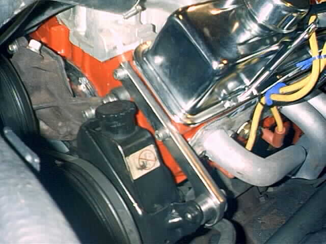

That is one sweet heavy duty bracket! But how did you makeit so the belt tension could be adjustable? Here is my really hokey PS bracket. It works fine for now, but when i pull the engine i will build some AL bracketry!!

If you look closely (I know the pic is a crappy one, sorry) the bolt that is out front, down low, on the SS bracket, is in a slot, on the bracket. I took a 1/2" by 2" peice of SS and TIG welded it to the side/end of the 1/2" by 1" piece then cut a slot in it on a mill at work, and rounded it up with a pea-nut grinder, and buffed it out the best I could.
It was easy and FREE! I made it out of scrap I pulled from the metal bin at work.
