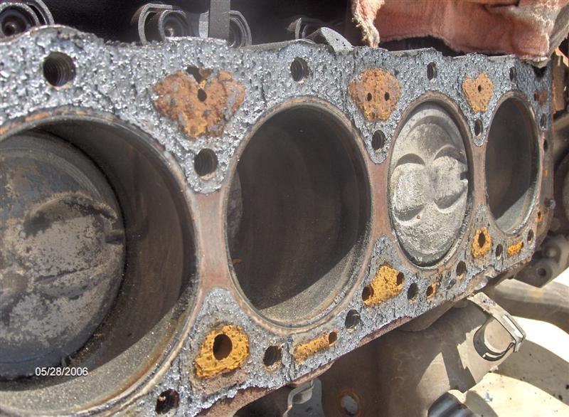

took the motor apart
well after 20 months of being lazy with this car i finally got it out and took the whole engine apart. and still with the heads off and the only thing rotating is the short block, the engine will still not turn over. the heads seem to be in OK condition. i have yet to take the oil pan off to see whats going on in there, but heres some pics of the combustion chambers, looks pretty nasty, but i dunno.

Old Jun 24, 2006 | 06:39 AM
84 Z-28 350's Avatar
Joined: May 2001
Posts: 704
From: Houston TX
Car: 84 Z-28 Camaro, 2022 2500 silverado
Engine: 383
Axle/Gears: richmond 3.73, eaton posi
I can't really tell from the pics, but what do the cylinder walls look like...they should be nice and shiny and have fine little scratches in them at about a 45* angle to the piston, there should be no other marks, and the scratches should be so small that you will need to look really close to see them, also...all that debris in the cylenders....that's from you taking off the heads I hope, it doesn't look like you were burning any water, if you were the leaky cylinder would be steam-cleaned and look brand new, sounds like you may have spun a main bearing, when U get the pan off take some pics of the rod and main bearings so we can see what they look link
