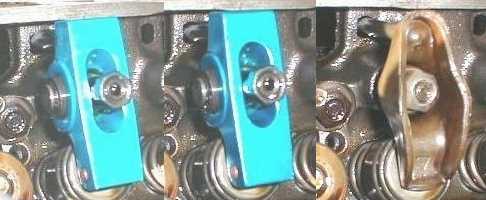

Think this did it?
The one on the left is the 1.5 on the exhaust with the lifter up. It is hitting the slot in the head. The middle is the 1.6 swapped in. The right is an OEM swapped in.
Two things could be the cause. Roller cam heads relocate the slots for the shorter pushrod/longer lifter and the proform design does not work with longer pushrods of flat lifters. Or, proform rockers do this on all GM heads with pushrod slots.
I never heard of the later nor have I ever known the slots in the heads to be relocated.

ol' fashion non-SA. The reason for the contact is, as I believe, the Proform design is a touch too long compared to OEM rocker as seen in the photo.
I am just wondering if this indexing would cause the pushrod tip to flatten or do I need to keep checking other posibilities? What does indexing usually do as far as damage goes?
