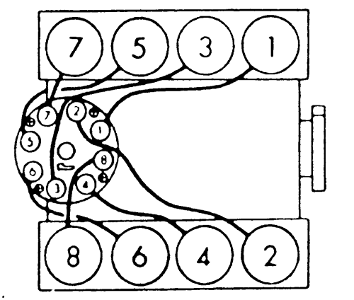

Your problems may be related. 1st thing to do is make sure you have the spark plug wires going to the proper cylinders.

yup make sure it looks sorta like this ....

wirering....
i own a haynes book with this diagram and im sure at 100% that my wirering is find alreaddy. How my car would sound like if the distributor is one tooth off?
