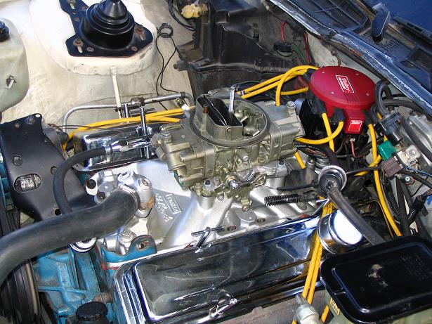

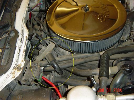

On my engine now, i have the one tube ( i belive this is the pcv tube) that goes from my drivers side valve cover into my manifold. On the passenger side i have the tube pictured below. This is the one i would swtich over to a breather correct?

i should prob put the pic in..
(yea its dirty, its also an old pic. Just using it as refrence.)
Yes, that is the one that brings filtered fresh air into the crankcase either via that foam element in the air cleaner assembly or from behind the filter element in the air intake stream or through a breather element (filtered as well). It is important that this intake of air to the crankcase be filtered so the fresh air is clean. Keep in mind that baffles are often necessary to keep oil from splashing up into the filter element and being forced out under high RPM conditions where the crankcase needs to vent out through the breather. This will make the big mess of oil spattering around under the hood that people refer to when running breathers that are open element ones. A good baffling setup will stop this on most engines. If you have excessive blow-by it will tend to generate so much crankcase pressure even under normal operation that the PCV system will not operate properly and the breathers will become soaked in oil and make a mess even with good baffling.
I have always run an open element on one side and a PCV valve on the other side on my engines. Either that or leave the factory system in place.

Yes, the tube in your pass side valve cover is the one you replace with a breather cap. All that tube does it act like a breather, but it pull in air from your factory air cleaner.
