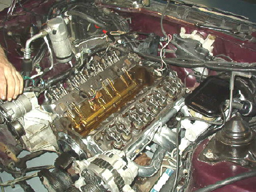

And they were also my choice for my 305 build up.
Lookin' mighty sweet :hail:
