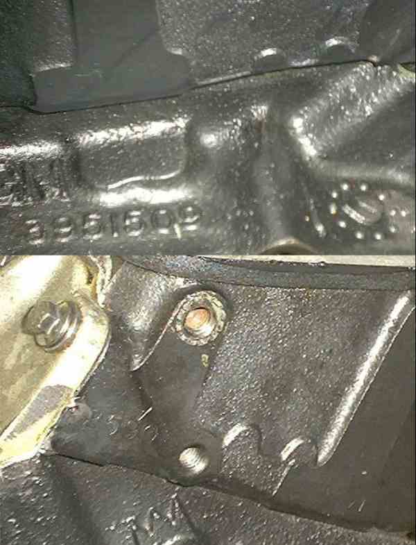

Some double hump heads do have the holes; some do not. There is NO WAY to fake the holes if the heads don't have them, that will produce satisfactory results. Which is why you can pick up the old ones without holes so cheap.... they can't be used in cars built in the last 30 years or so.
These are 186 castings.
