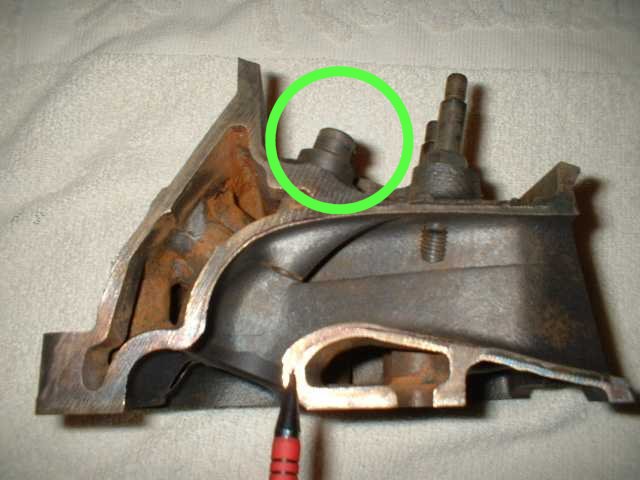

heres a pic of yous can tell if not i'm sure theres some kind of marking on them of some sort

crazy3rdgen,
Are those pics of your heads? If so, those aren't Vortec heads.
See the little "hump" between the accessory holes? That's not what Vortecs have. Vortec heads have three little pyramids lined up in a row.
They look like this....
Yours don’t have that.
What's the casting number on those heads?

The only Vortec heads that you want have casting numbers 906 or 062... anything else, it's not the heads you want. There no such thing as "almost as good".

Casting numbers tell all. If they end in "906", then they are Vortec (10239906 is the full Vortec number). Other than that, looks are nothing more than hints. Things like the markings, the intake bolts, etc.

Here's a pic of a head, cross-sectioned through the intake port.
Look at the thing in the green circle. That's the valve guide. The valve stem goes through it, the spring goes around it; the retainer sits on the end of the valve, somewhat above the top of the guide. The exhaust is basically the same.
Vortec heads have a HUGE guide boss. It's bigger around at the bottom than the one on this head; and it's taller. It prevents the valve from being able to open (pushed downward) more than .460" or so, because the retainer runs into the guide. Additionally, the outer diameter of the pocket in the head where the spring goes, is too small to accept anything except those weenie less-than-stock truck springs those heads come with; and the outer diameter of the guide, where it steps down rather like in hte pic except even bigger, is too large for anything but a single spring with no damper to fit down over it.

Here's a pic of someone's aftermarket head. Note how the spring pocket is much much larger, and the OD of the guide is much smaller. You can fit altogether more spring into this head, than any stock head; but especially Vortecs. And you want all the spring you can get, up to a point, to control the valve motion, and keep it from bouncing off the seat when it closes.

OHHHH!!!!!!!!!!!
i'm pretty sure i totally understand now, so if the cam is big and is making the push rods rise too much then the rocker is forcing the spring down all the way to where the rocker is hitting the valve guide.. am i right?

Almost.... but, it's the retainer that will hit the top of the guide, not the rocker. The retainer is the large round piece on top of the valve spring.

ohhhHH i got ya.. that makes so much sense to me, that would be a disaster i'll tell the guy what cam im runnin or that i "will" run when i figure that out and im sure he'll know how much to machine them or is there a standard lenght
