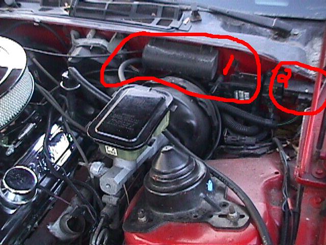

What are these two things in the pic and what do they do.

parts under hood
#1 is a vacuum reservior. You need that to operate your a/c-heater-defrost controls.
#2 looks like a MAP (manifold air press) sensor. There should be a vacuum line running from it to the intake manifild. You'll need that if you want the computer to know how much load is on the eng.

vacuum res..what does it run from casue right now vac line is just hanging there...

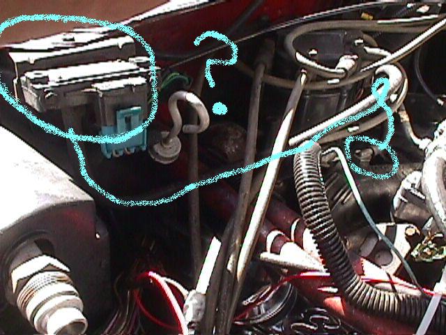

map sensor (#3) ? its not hooked up to anything. The only line coming from the manifold is in the 2nd pictue....What is that?
1st pic what are #1 and #2?

whats this?

in the last pic thats you map sensor see how a vacum line goes form your intake to the senssor that cause it messures diffrenace in pr3ssure form out side are to air in the manifold. no clue waht the others are

Ok how about the vacuum reservoir what does that run off of?
ok how bout the cc what do i need to do to get rid of it? What do i have to change?

After seeing the last pic, I agree, that is the MAP sensor next to the dipstick. Not sure what that is on the far left side (#3 in next to last photo). Is that a vacuum line coming off the bottom??
Item #1 in that same pic is the ESC (elec spark control) module. On later years, it was replaced by some circuitry on the Memcal.
Item #2 is a relay.
On my car I have 3 identical relays in that same area. Fuel pump, MAF power and MAF burn-off. Since your car has no MAF (mass air flow), I'm assuming that is the fuel pump relay.
The vacuum reservoir connects to intake manifold vacuum via the large line. (If you're not going to use the computer, the vacuum reservoir could connect where the MAP sensor is connected) The small line should be going to the inside of the car. The vacuum provides the muscle to control where the air comes out (defroster, heater, A/C vents, etc). If vacuum is lost, air should come out the defroster vents only. This is its' default mode. For safety reasons you want the windshield clear.
